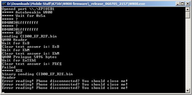

Dear Abhishek, after reading all the replies. i am still confused :S . i have read your readme file again and again. I understand its for CID36 only. Now when i I run W800.exe, it gives me an error and doesnt give me a chance to write the CDA. The last line says the phone disconnected, you should close me!
Tell me, cant i get it done to W800i ?:frowning:
Pls help.
can u plz post some screen shots so that i can figure out whats the problem..?
Ok dear here it is…hope you get the cure. I suspect my phone is CID49 and not CID36.
Still help me if u can.
hmmm srry to say but it seems ur phone cannot be converted to w800 :frowning:
