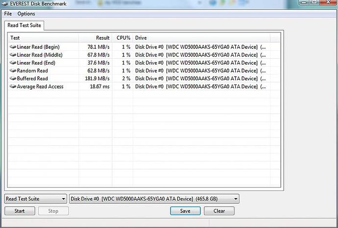

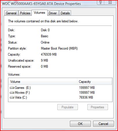

Can you please post a screenie of this drive as shown in Windows Disk Management.

now where is DISK management in VISTA ??
is this wat u wanted to know !

Start > Control Panel > Administrative Tools > Computer Management > Storage > Disk Management (Local) !!!
