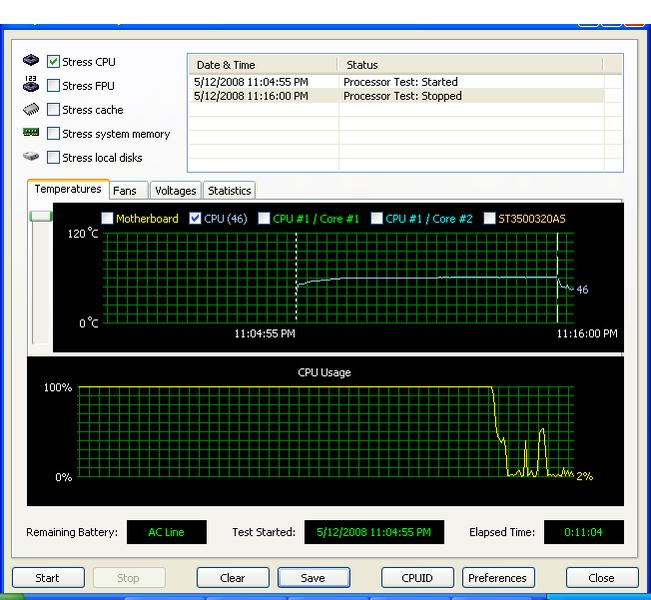

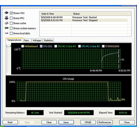

Some temp observation at room temp , no AC
The Northbridge is around 40 C normally
In idle state , CPU is 40C and around 35C with cool n quiet .
Under benchmarks & stress test, CPU temp shot up max to 56C

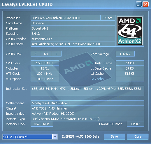

Well today i decided to give the reseating another chance and also decided to undervolt the processor to 1.1 V [as experimented by someone else having the same problem on Tom’s Hardware forums]. It seems the mobo is overvolting the CPU, as now the cpu runs pretty stable :D, i reduced the foltage to 1.1V [ which shows as 1.12V-1.15V]. The normal voltage as in the vicinity of 1.32-1.37V.

..i tried with the voltage as normal ..embarrassingly the system seems to be stable albeit with relatively high normal and peak temperatures[~40C as normal ad 61C as peak]. The voltage also seem to be following the same pattern [1.32V when idle, 1.36V when loaded].
