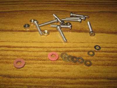

I did get screws washers and nuts for just such a purpose (picture attached) - these screws are very slim and they easily went thru the Nothbridge heat sink mounting holes on my A8N-E. The screws are made of stainless steel the washers are fibre and copper and the nuts are brass :slight_smile:
^^nice…but if i get an aftermarket one, they already have those things with it
I got a Thermalrigt HR-05 SLI Northbridge cooler and that came with a plastic push pin with springs, when I attached a 80mm fan to this HSF it was loosing contact with the chip, the spring was not holding it firmly against the chip, that is why I went to a hardware store and got these screws. I never used the screws - I just stopped using the HR-05 and went back to the stock A8N-E Northbridge cooler.
