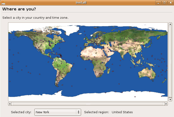

ok take a look at the pic below. this is what i can see in the 800 x 600 res. i can’t access the forward button. so i can’t install it.and i cannot resize the window either.
Change the reso,.., from System → Preference → Screens and Monitor :slight_smile: You are done buddy there are only 2 more steps :wink: ,everything is fine no driver problem .. Its because of low resolution :wink: I guess so :expressionless:
@Darky, that resolution option doesn’t work sometimes.
This resolution problem really sucks. One option is to press tab and try guessing the buttons and proceed with the installation.

^^Haven;t you changed the resolution after booting to desktop.. It should be System → Preferences → Monitor ? I am not using Ubuntu so I cannot be precise on the path :expressionless:
