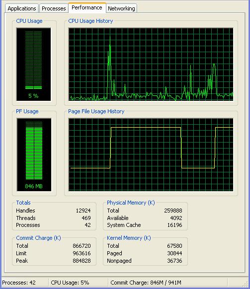

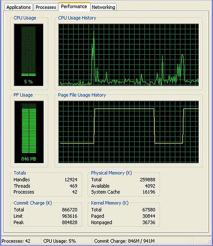

OK, as is said try to do your normal routine but keep the a eye on task manager after everytime you open or close a application.
Check the task manger/performance/commit charge :
Total : shows how much of PF you are currently using
Limit : shows how much of memory you have(physical + paging/virtual)
Peak : now this is important , it shows how much was the max/peak of memory usage. If it the peak is more than the limit then it is time to increase the virtual memory size.
Looking at the applications you mentioned, nothing their would need a paging file of over 500MB so maybe a application problem.
Anyways now your total should be around 250+800 i.e. around 1 GB of memory, just make sure your peak is below that. Also as i said before keep a eye on when or after using which program does it peak.

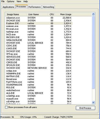

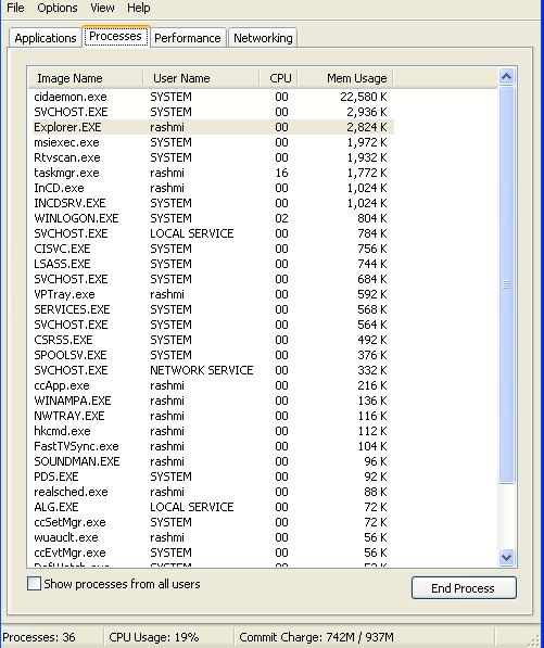

As suggested, i hv tried to monitor the performace through the task bar with all the applications closed. I hv noticed that maximum memory is being consumed by msiexec.exe and cidaemon.exe. There were instances when memory consumption by cidaemon.exe reached the order of 120, 000 KB even when i had left my comp untouched with all the applications closed.
at one of the peaks givn below was the task mgr’s reading-
**Total **: 866720
**Limit **: 963616
**Peak **: 884828
I m attaching two screen shots of the task mgr.
Will increasig the maximum limit of the virtual memory help?

cidaemon is the indexing service daemon, typically known to use a lot of cpu cycles. Turn off the indexing service or set its cpu priority to low.
Forgot to post the method:
Start > Run > services.msc
Scroll down to Indexing service and turn it off to set to manual.
This is what cidaemon does,
If you use Microsoft Indexing Service, cidaemon.exe might explain the high CPU utilization. This process builds and updates the Index catalog and typically uses a lot of CPU time. However, cidaemon .exe is also set to run at a low priority, so it usually doesn’t degrade the performance of the system even if it’s at a high CPU level.
This is how you can stop it
Windows XP includes a new feature called ‘indexing’ which constantly creates and updates an index of files in your PC. This index is mainly used for speeding up file searches. The indexing feature is largely useless unless you find yourself using file search a lot, and it sucks up system resources, so it is recommended that you disable it for performance purposes.
To turn off file indexing go to Control Panel\Add/Remove Programs\Windows Components. and uncheck ‘Indexing Service.’
Also increase your PF to 1GB just to be safe.
Their are just too many applications running in the background, run msconfig and disable all startup items not required.
Edit : Blade also has posted the right thing, either make it the indexing service manual or completely disable it for your profile, or the best solution is uninstall it like i mentioned above.
