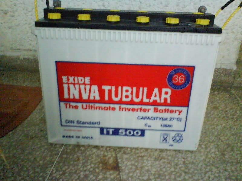

Received the new batteries yesterday
http://img.photobucket.com/albums/v300/paras_mann/DSC00095.jpg

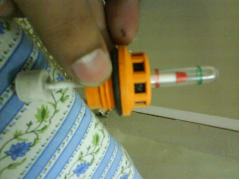

May we know the cost and warranty terms like second year, third year etc? Also, the Inva tubular ones in our office and other places where I have seen it has test tube like caps in place of the yellow caps in the picture!
The testtube caps one is the one i hav at me place..
the tube caps you are talking about have a kind of float inside them to check the water level. they come in normal batteries too. usually the batteries come with normal caps and the tube caps are supplied in a small packet, otherwise they can break. (this was the case with my mom’s microtek inverter with a normal exide battery.)
http://img.photobucket.com/albums/v300/paras_mann/DSC00097.jpg
there is a low height tubular battery too which costs 9500
these batteries set me back by 10800 X 2 for the batteries, 1000 for a new trolley minus a buyback of 2000X2 for the old batteries.
warranty terms as per the dealer were - it is known as warranty but if any fault arises the batteries are replaced with new ones during the three year warranty period and not repaired as repairing costs turns out to be more expensive for exide.
Anyway i am 100% sure there batteries are not going anywhere for 3 yrs!!!
